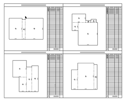

I'm trying to write a GDL for the sale area table.
The dedicated areas A to H are filled with fill and connected with labels to increase the area.
make it show up.
And you must bring the entire shared area.
When you create an area table, do you create it only as an input?
Or are you using a method to get data?

2022-07-04 12:07 PM - edited 2022-07-04 12:13 PM
I read this post
It's not what I want.
Zones are used for each room area.
However, we do not use the area for each type.
Just create a dedicated area and a common area for each type with Fill.
(Do you make these zones with the "zone tool"?)
In this way, the total area for each floor and the common area for each floor are created and summed to obtain the total common area.
