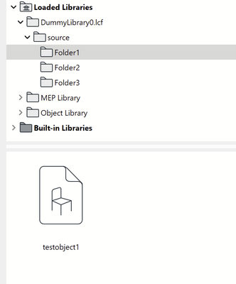

Libpack and folder/file structure (not reading the translation)
I am trying to uderstand how the folder structure translation works. I have created a dummy library with 3 files. All what I need is the folder/file structure change, so I do not need now *.po files, just pathNameTable*.json. I did only INT for the sandboxing.
I cannot get it to work, probably some silly mistake.
Loading this folder as a libpack does load it straight without translating the path.
Can anyone help with it? Please

ZsuzsannaB
Hi Piotr!
I'm not sure I understand your exact issue; please help me clarify a few things first so that I can help.
Do you mean by "loading this folder as a libpack" that you have compiled it with the LP_XMLConverter into .libpack format?
By "without translating the path", do you mean it doesn't change to the virtual paths defined in the pathnametable file?

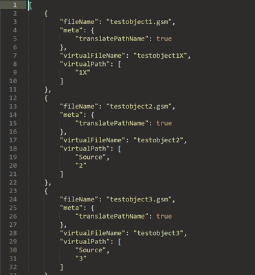

I need only to apply the directory/filenames changes while translation is done, so I assume I have to include only pathNameTable*.json. I did myself a sandbox library with 3 objects in 3 libraries. In the sandbox I included only INT translation.
For testing purposes I initiated the option in GDL editing toolbar so AC 28 interprets the folder content as a libpack.
Anyway it does not work with the changes in pathNameTable*.json, I probably did a silly mistake...because I checked in some of the GLOBAL Lib libpacks and it should work.
So I need to know what I did wrong  😛

Your issue is in the package.info file. Try adding the empty <Dependencies></Dependencies> tag, so that the info file is valid. 🙂
Unfortunately it is not the case 😞  I tested it also with this tag, without it, and fully copied tag from the libpack I have extracted from global library.
when loading the whole thing it always show as the native path in lcf.
json file looks like this:
and in AC:
So I am missing something that triggers the translation some way  😞
ZsuzsannaB
I have tested your folder, that's why I suggested this, because without this tag, it didn't work for me either. The same applies to the localizationData.info file. Even if you don't have dictionaries, you need the empty tag in the file and so on. I've attached a version that works for me.
My last resort is, maybe try checking if your Localization Preferences are set to "INT".
