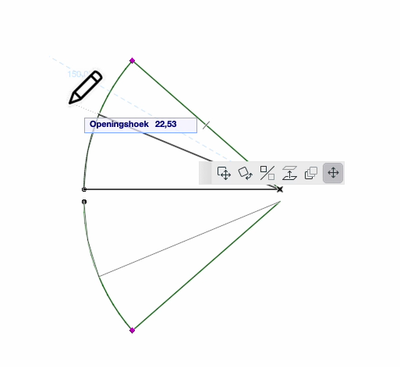

When I mirror the Editable Angle Hotspot something goes wrong. How can I mirror this (without creating a new hotspot for mirrored cases, because the hotspot is in a macro)
Normal:
Mirrored
Code:

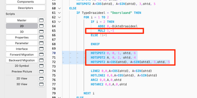

FOR i = 1 TO 2
	IF i = 2 THEN
		ADD2 0,-DikteDraaideel
		MUL2 1,-1
	ELSE !i=1
	ENDIF
	HOTSPOT2 0, 0, 1, ohtd, 6
	HOTSPOT2 A, 0, 2, ohtd, 4
	HOTSPOT2 A*COS(ohtd), A*SIN(ohtd), 3,ohtd, 5
	LINE2 0,0,A*COS(ohtd), A*SIN(ohtd)
	HOTLINE2 0,0,A*COS(ohtd), A*SIN(ohtd)
	ARC2 0,0,A,0,ohtd
	HOTARC2 0,0,A,0,ohtd
NEXT i

The mirrored hotspot needs it angle of rotation reversed with a 512 attribute value.
Change the rotating hotspot (6) to this ... HOTSPOT2 0, 0, 1, ohtd, 6+512*(i-1)
When i = 1 it will not reverse (512*0).
When i = 2 it will reverse (512*1).

I am glad it was this easy, though I still had to transfer another parameter to the macro. Thanks Barry
