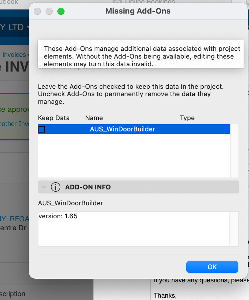

No bug report just computer shuts down!
In the last week when opening drawings I've been getting this Missing Add-ons message. I think it might also be linked to my computer shutting down and report saying threat detective. Can someone help me understand way this message has started popping up and how I can resolve this. Thank you
1 Solution
That message in your image, is just telling you that when the file was created (on a different machine probably) that there was an add-on used called AUS door/window builder.
You don' t have that add-on installed so it can't be used on your machine, but it will retain the data in the files so it can be used again when the add-on is installed or is opened on the original machine with the add-on present.
As for the report saying 'threat detected', that sounds like your anti-virus software.
You may have to set it so it ignores all Graphisoft programs and files.
