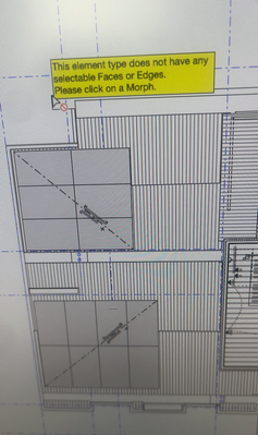

Ever so soften, (Apple M2 Max MACOS 15.6.1 (24G90)) the mouse loses all ability to interact within the archicad window. You can still drag the application window around, you can select plot layouts from the navigation menu and double click to bring up, but the layout doesn't appear. Right click rebuild etc is available as a pop-up menu but nothing happens. 3d Window no controls work, but you can double click on the zoom to extents palette and the previous zoom. So it seems like anything on a pallet or drop down menus will operate but selection of model elements or interaction is gone. No cursor, no object detection etc. Restart is the only fix, sometimes a complete computer restart.
Except, after leaving alone for a few minutes, selection has returned but gives the yellow box message below:

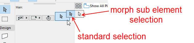

It looks to me as if your selection tool (Arrow) is in sub element selection mode.
This only works with morph elements.
Try switching back to standard selection.
Yep sure, except the mouse wouldn't accept any tool selections or palletes. Had to restart to restore functions...
