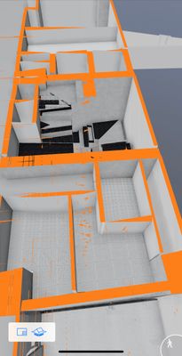

Archicad AC25 Update 5005 Issues
Ajaytonpe
Archicad Team,
We are facing major problem post this update...

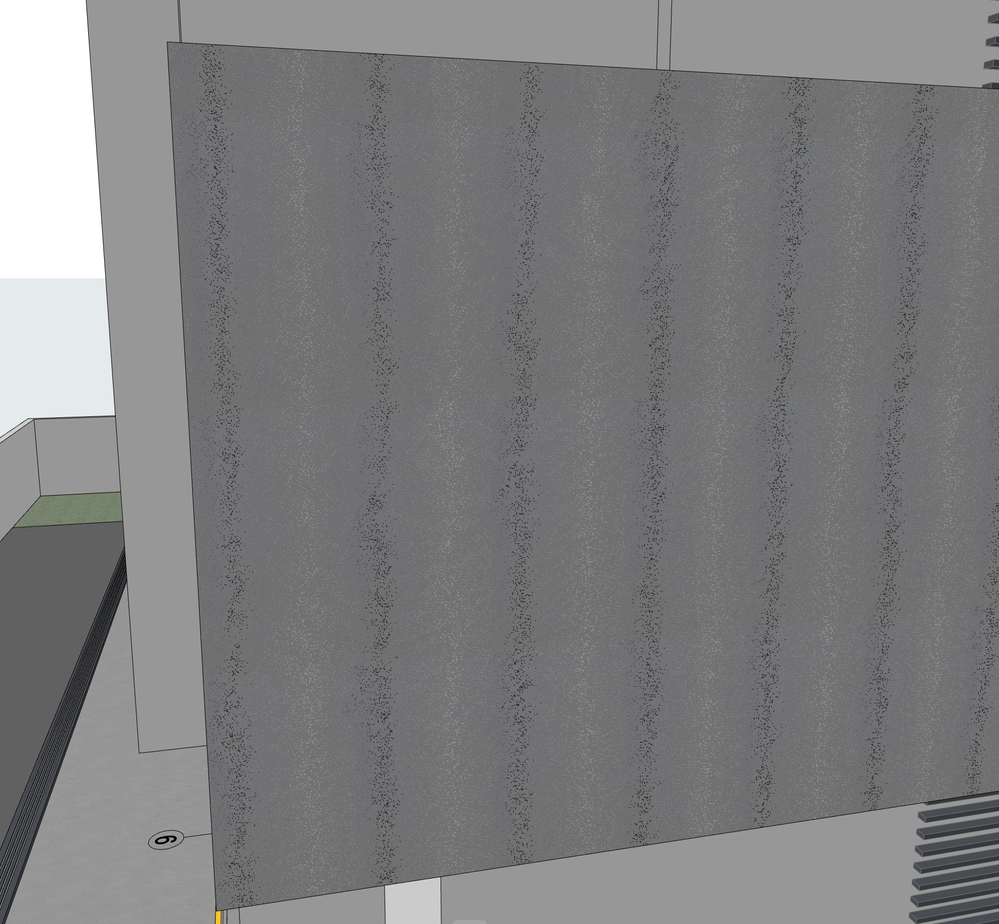

1. there are major graphics bugs (all curve lines , staircases are not showing properly)
2. Image maps are showing pixelated.
3. same thing is going in BIMx. (BIMx file runs very sluggish, sections shows odd geometry)
Its a serious issue in our workflow. we are using BIMcloud advance. so all machines and all projects got updated.
Kindly give us solutions asap.

Hi Minh,
there is no issue in local file... its on BIMCLOUD file.
also we are not having issue for far from origin.
AJAY_T
Dear Ajay,
If that's the case, then the issue is not with the Archicad update, but there must be something else with your model in BIMcloud. I strongly suggest contacting your local support with the information you had here, as they will be able to offer direct support at your convenient time.
Thank you for your understanding!
Best regards,
Minh

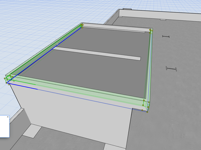

dushyant
Facing the same issue with a bimcloud/teamwork project.  When an element is selected, the snap points are not aligned with the geometry. Attaching screenshot.
Hello,
Thank you very much for the question!
Same as above, I'm wondering if you save a local copy of the project as PLA format, will the same issue happen? Furthermore, I would like to make sure that the project is not suffered from Far from Origin issue.
Best regards,
Minh
Minh Nguyen
Technical Support Engineer
GRAPHISOFT
There is no issue in the local PLA/PLN file. The issue arises only when it is shared on teamwork.
