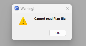

I know I'm not the one who encountered this situation, but it really gives me a headache today. Yesterday, I was still working. However, today I am unable to open the file, and the repair option also fails to work. Additionally, the FDB backup cannot be opened or read. Any suggestions?

Are you possibly trying to open a version 28 file in say 27?
That won't work.
If that is not it, what is the file size.
If 0 KB or very small, then the file is corrupt and you won't be able to do anything to fix that.
What warning messages are you seeing?

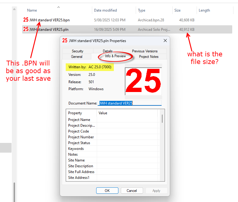

What is an FTB backup?
There should be a .BPN file in the job folder, that can be opened and will be as good as your last save.

Just ver 25... opening the file this is the warning message.
trying to open and repair thisis the warning message
Sorry my bad its fdb NOT FTB - wrong text. trying to change that to pln... still failed.
Are you sure you (or a co-worker) didn't save the file in version newer than 25.?
That is exactly the message you will see when you try to open a 26 file in 25.
Right click on the .PLN file in Windows Explorer and see what the properties say.
Be sure to look at the 'Info& Preview' tab.
