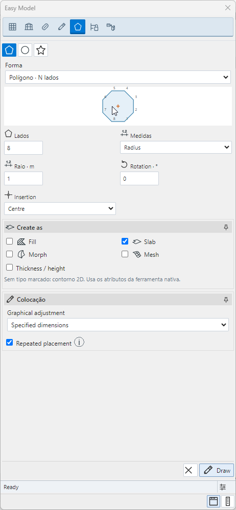

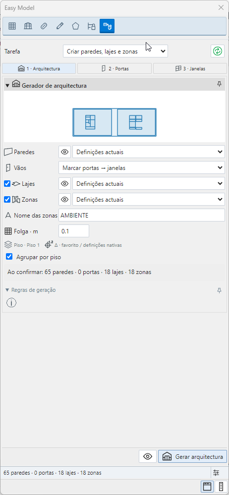

Greetings everyone, in this Video  I present some functionalities of some add-ons that I am developing for ArchiCAD, consisting of 9 modules in total, among which the following stand out:

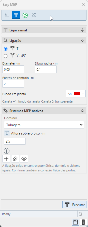

Easy MEP — Streamlines the creation and management of electrical, water supply, and plumbing installations through the automatic creation of dynamic elements. Captura_N3h & 13-10-2026.pngCaptura_N3g & 13-10-2026.pngCaptura_N3f & 13-10-2026.pngCaptura_N3e & 13-10-2026.pngCaptura_N3d & 13-10-2026.pngCaptura_N3c & 13-10-2026.pngCaptura_N3b & 13-10-2026.pngCaptura_N3a & 13-10-2026.pngCaptura_N39 & 13-10-2026.pngCaptura_N38 & 13-10-2026.pngCaptura_N37 & 13-10-2026.pngCaptura_N36 & 13-10-2026.pngCaptura_N35 & 13-10-2026.pngCaptura_N34 & 13-10-2026.pngCaptura_N33 & 13-10-2026.pngCaptura_N32 & 13-10-2026.pngCaptura_N31 & 13-10-2026.pngCaptura_N30 & 13-10-2026.pngCaptura_N2z & 13-10-2026.pngCaptura_N2y & 13-10-2026.png

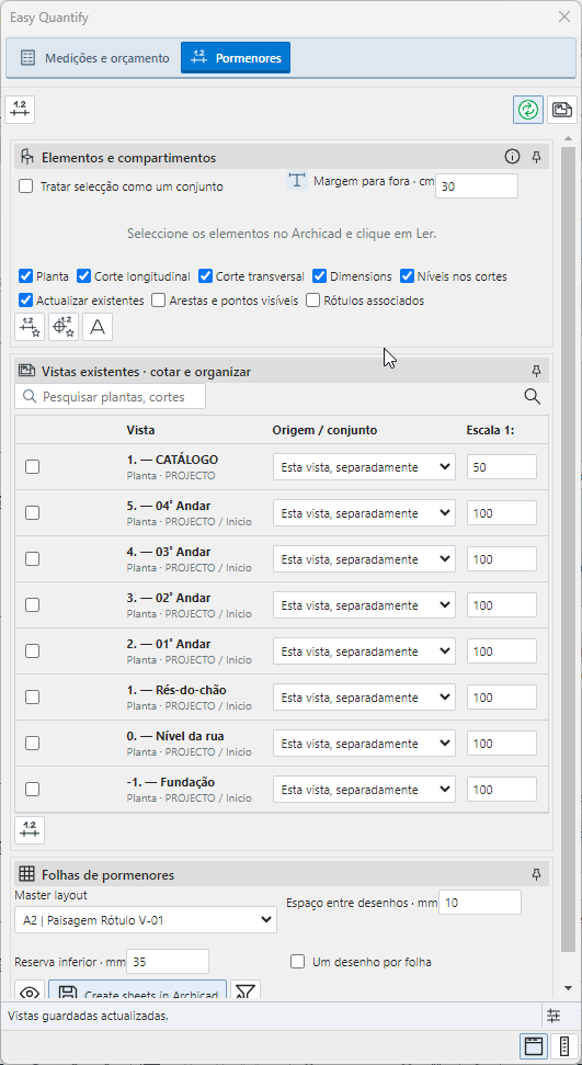

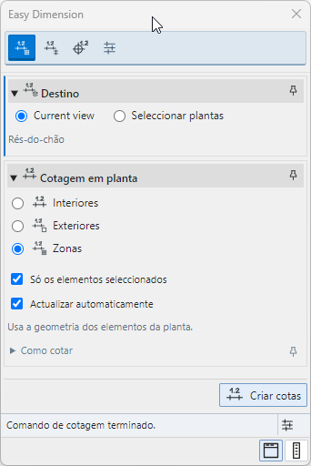

Easy Dimension — Automates the dimensioning of plans, sections, and elevations, with linear and level dimensions.
Easy Grid — Makes it easy to create structural grids and distribute columns and beams by selecting only the walls.

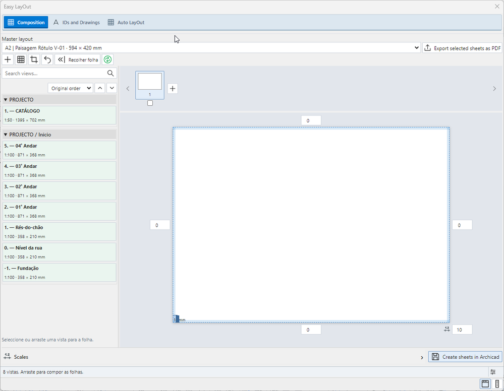

Easy LayOut — Automatically creates layouts (sheets of paper) from a set of views (plan, section, elevation, detail, etc.). Positions the views, defines the scales (based on the view size or a predefined scale in multiples of 5, such as ESC. 5, 15, 75…).

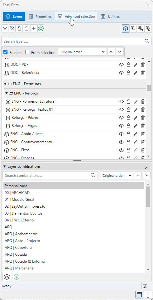

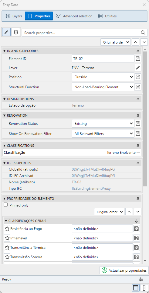

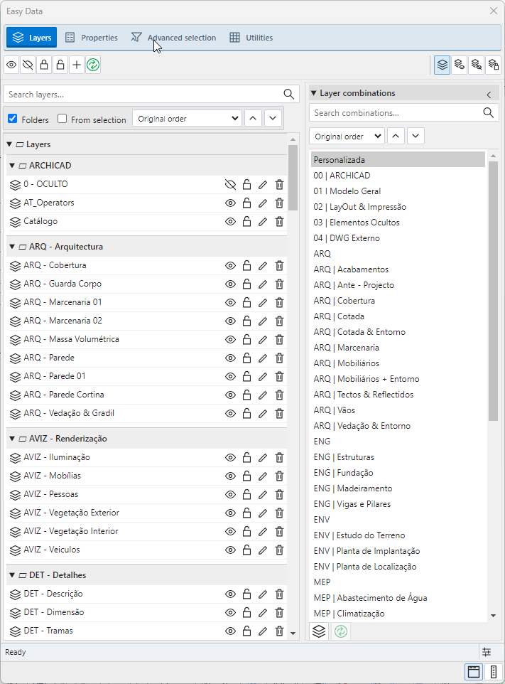

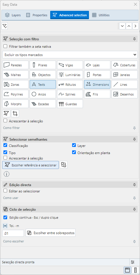

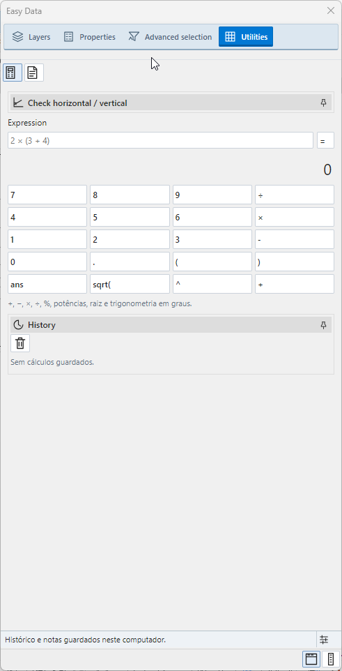

Easy Data — Centralizes the management of layers, combinations, and properties, with advanced selection filters directly in the ArchiCAD interface.

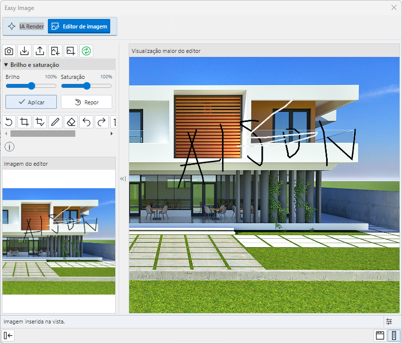

Easy Image — Combines image editing and render preparation with adjustments for brightness, saturation, cropping, rotation directly in the ArchiCAD interface and preview.

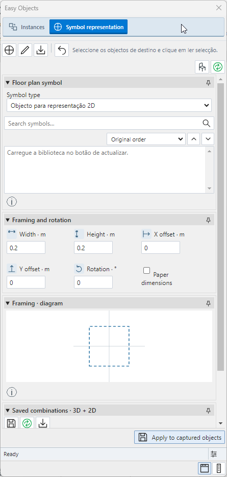

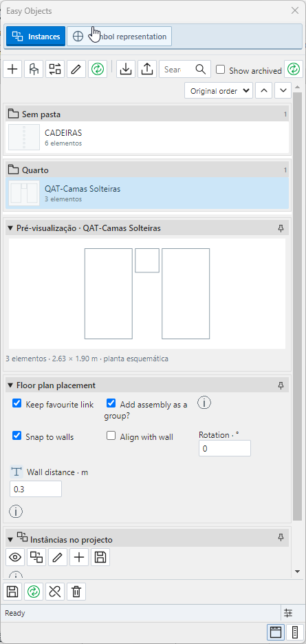

Easy Objects — Allows you to save and reuse sets of objects by associating 3D representations with custom 2D symbols.

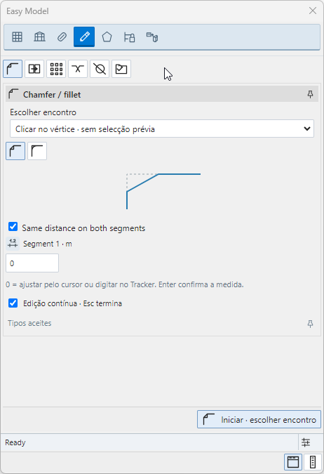

Easy Draw — Speeds up drawing and geometric editing with polygons, chamfers, fillets, stretches, matrices, and constraints.

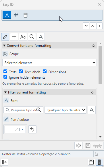

Easy Rename — Simplifies the management of text and IDs, with numbering rules, batch formatting, and change preview.
