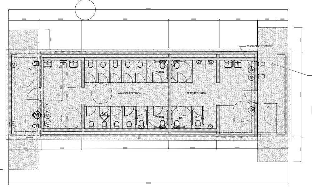

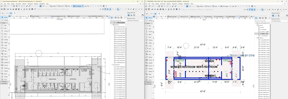

Left is v29 layout in 29

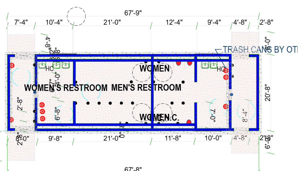

Right is a copy and paste of the info from left
Same version to verion and no stalls, no toilets no urinals. no partitions

also look.  no matter the display level the sinks are uder the slab graphicly
So graphics are bad and display order not working in a transver from 29 to 29

Trust me there is no problem copying from one version to another or even between the same version.
As you can see the walls  and slabs and some objects are coming across just fine.
The black dots are objects that have copied across but the correct library is not loaded so those objects can not be displayed.
Make sure that you have the same libraries loaded in both files and there will not be a problem.
Look at the Library Manager in the file you are copying to and you should see a "missing" library and some warnings about missing objects.
Show an image of your library manager and we might be able to work out what is happening.
