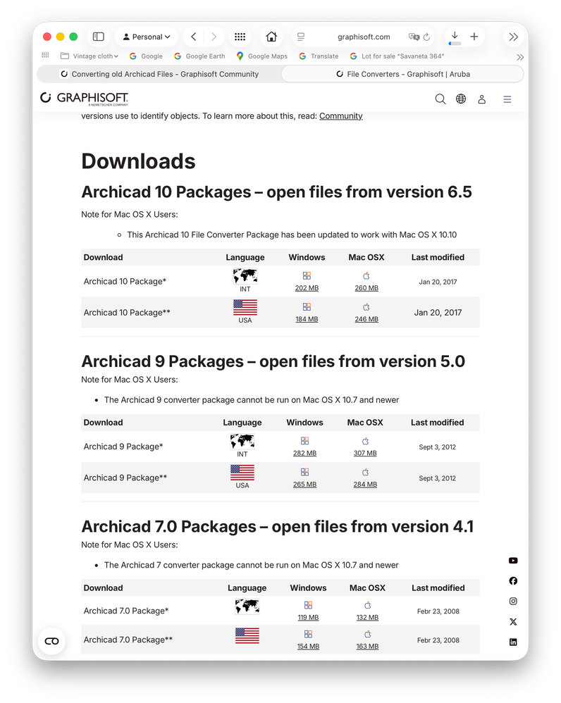

However, I have encountered a challenge. I downloaded both the USA and the International versions of the software for AC 10. When I double-click the ".dmg" file, it opens a folder, but I cannot find an installer inside. At this point, I seem to have reached a dead end.

Screenshot 2026-06-16 at 7.26.14 AM.pngScreenshot 2026-06-16 at 7.29.23 AM.png

There is no installer for Archicad 10, and your screenshot shows that Archicad.app cannot be opened on your macOS.
You would need a computer with an older version of macOS.
If you wish, I still have a computer that can open Archicad 10. I could therefore convert your file.

I decided to install Parallels on my laptop running macOS 26.5.1 and then try to run the Archicad 10 conversion setup in order to open my old Archicad 7 file.
Unfortunately, I have not been able to get the converter installed. It appears there may be some compatibility issues with macOS/Parallels environment. At this point, it seems that I may need to find access to a Windows PC laptop, in order to run the converter successfully, unless someone has a suggestion or workaround that I have overlooked.
My goal is simply to recover the building geometry and eventually migrate the project to Archicad 29. I understand that many library parts, objects, and attributes may be lost during the conversion process, which is not a concern for me. The most important elements are the walls, slabs, and roofs, as recovering those would save a significant amount of time compared to redrawing the project from scratch.
If anyone has experience converting Archicad 7 files or has advice regarding the installation of the old converter software, I would greatly appreciate your help.

I have no idea about MAC and Parallels and whether the 10 converter will run, but it is not a program you need to install.
It should simply be a ZIP or compressed file you need to expand to your local hard drive and then run the Archicad program file.
