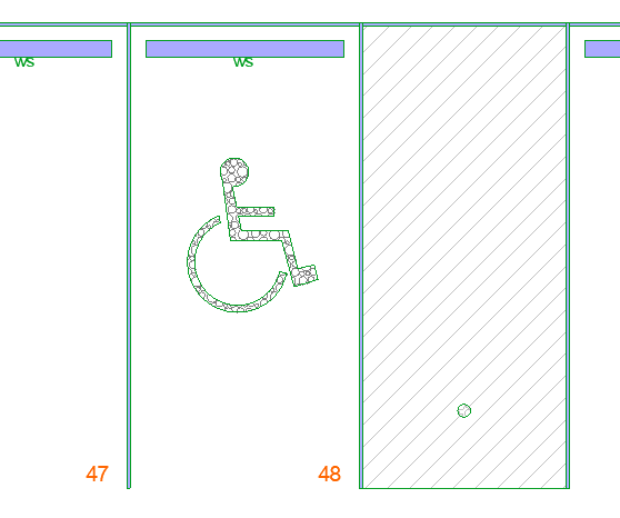

Before I try it, some stupid questions:
- Why do the disabled parkings not have the access/egress area marked?
- Does it follow the terrain/paving slope?

Hi Djordje,
I did not know there was a requirement to mark the access/egress area but there is a "Shared Area" option which you can put beside the disabled.
We can also very easily expand on the type of bays available and the markings/symbols they require. You can currently set eight different bay types (expanding to more soon) but the symbols have to be added into the object by us.
Yes it does follow the terrain. I forgot to demonstrate this but you can see a brief demonstration in the intro and outro of the video or you could view the functions in the video of our original Swift Parking object which this grew out of:

Thanks Kristian, symbols attached. I've attached disabled and parents parking symbols as well as the EV charging symbol, simply because they match.
The other thing we have in the UK is a chevron arrangement along 2 sides of disabled bays.
 Another nice thing to have would be an option for a mesh at the base. We often have a different material or colour for the actual parking bays.
Having it in the object would allow us to do an SEO on the topo mesh.
Are there options to turn off the 'long' and end stripes?
These things should give complete flexibility for pretty much anything.

Thanks Jim,
Yes we do already have a chevron option for beside disabled bays, it is its own bay type but does not get counted as a bay in the scheduling.
Adding a mesh to the base will be a simple upgrade so I will try to get it done with the above upgrades.
Yes you can turn of the long and end stripes.
I will let you know when I get the upgrades into the tool, most likely later this week.
