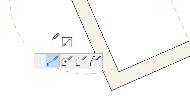

Creating Guide Line Segments
Generally, Guide Lines are infinitely long. Although, sometimes you will only need segments of it (e.g. to activate Snap Points).
To create a segment, either right-click any Guide Line tab or click the Guide Lines pop-up menu from the Standard Toolbar. select “Create Guide Line Segment”.
A pet palette appears. Select the line segment option, then draw the Guide Line or Guide Circle/Arc.

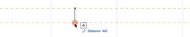

To move a Guide Line, place the cursor on the line and wait until an orange dot with four arrows inside appears. Move the cursor onto it.

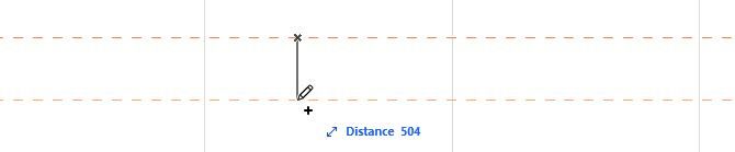

Click-and-drag the handle to drag the Guide Line to a new location. You can either place the Guide Line on another edge or define a specific distance by entering it in the tracker.
To copy a Guide Line, click on the handle, press “CTRL” or “Option”- key once while dragging it. Now a “+” should appear next to the cursor, which indicates that a copy will be made.

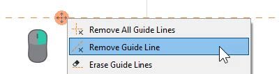

Removing Guide Lines

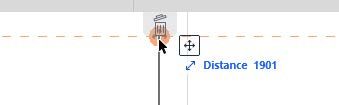

There are different options to remove existing Guide Lines. For example, you can click the orange handle to drag the Guide Line to the nearest garbage can.
The second option is to right-click on one of the Guide Lines and select “Remove Guide Line”.
Another alternative is to press the “ESC” - key while the cursor is on the orange dot. To remove all Guide Lines at the same time, use the command “Remove all Guide Lines” either at the menu, which appears when you click right or at the Toolbar. To remove several Guide Lines, use the command “Erase Guide Lines”.
By doing this, the shape of the cursor turns into an eraser. Now click and drag the cursor to erase Guide Lines.
