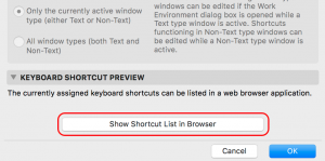

The currently assigned keyboard shortcuts can be listed in a web browser application if you click on the Show Shortcut List in Browser button at the bottom of the Work Environment dialog.

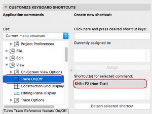

Step 2: Select command
From the list window, click on the function or command that needs a shortcut.

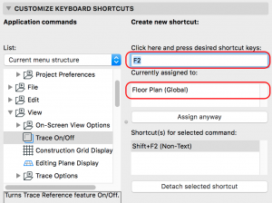

If the selected function/command already has a shortcut assigned to it, that shortcut is displayed in the Shortcut(s) for selected command window on the right. In this image, the selected command already has a shortcut (Shift+F2).
To assign the shortcut despite the collision, click Assign anyway. This action assigns the shortcut and detaches the shortcut from the function/command to which it was previously assigned.

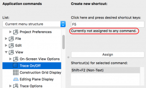

If the combination you typed has not yet been assigned to any other command, you will see the sentence: “Currently not assigned to any command”.

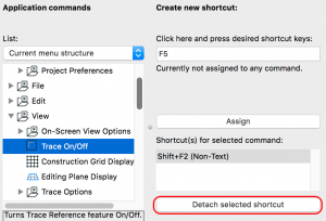

Click Detach selected shortcut to remove the existing shortcut. If you don’t detach it, you can still assign another shortcut; this way the function/command will have multiple shortcuts.
