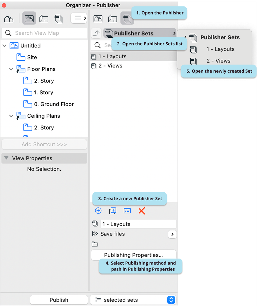

  • Open the Organizer (Palettes > Organizer or from Navigator) and switch to the Publisher Map to access or create Publisher Sets.
  • In the Organizer, keep the Publisher Map on the right, and View Map/Layout Book on the left.
Create new Publisher Set
  • Click the “Level up” button to see all the Publisher Sets.
  • Create a Publisher Set by clicking the New Publisher Set button (+ icon at the bottom).
  • Open Publishing Method to define if you want to print, save, plot, or create a BIMx file.
  • Setup where to publish, the path.
