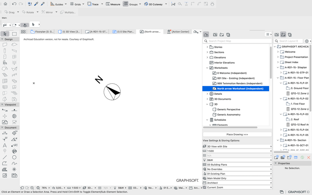

Step 1: Create a Worksheet and add the shared content
  1. In the Project Map, go to Worksheets and create a New Independent Worksheet. Name it clearly, for example Legend, Graphic Notes, or Fire Safety Notes.
  2. Open the Worksheet and draw or paste everything you want to reuse: text, symbols, diagrams, scale bars, arrows, logos, QR codes, etc. This content now lives in one place only.

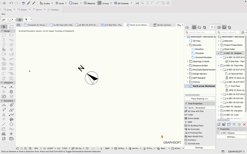

North arrow placed in an Independent Worksheet
Step 2: Save a view of the Worksheet
  1. With the Worksheet open, right-click it in the Navigator and choose Save Current View.
  2. The Worksheet now appears as a view in the View Map, ready to be placed on layouts.
Step 3: Place the Worksheet on the first layout
  1. Open the Organizer, set one side to the View Map and the other to the Layout Book.
  2. Drag your Worksheet view from the View Map onto the target layout and position the placed drawing where you want it on that specific sheet.

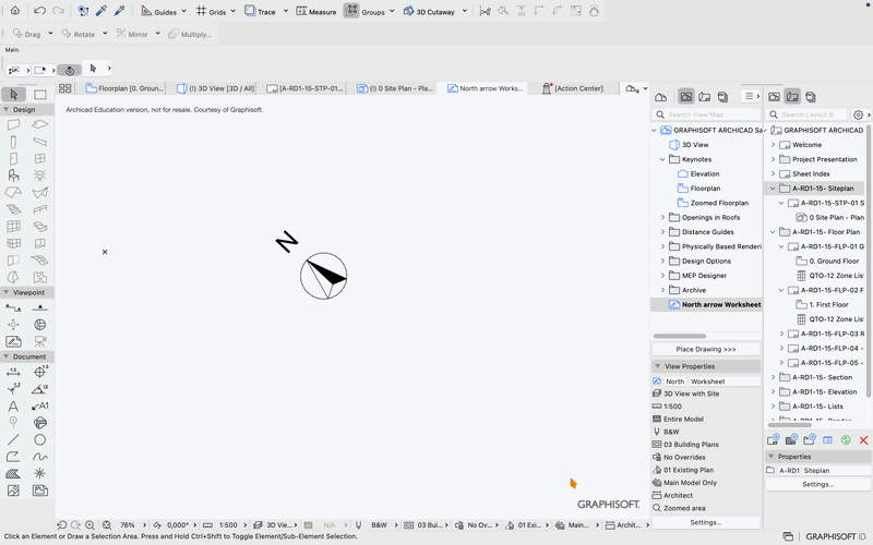

Step 4: Copy the drawing to additional layouts
  1. In the Layout Book (Organizer or Navigator), find the layout where the Worksheet drawing is already placed and select that drawing in the layout’s content list.
  2. Hold Option on macOS or Ctrl on Windows, then drag the drawing to each additional layout.
  3. The copy will land at the same position as the original. Reposition it on the layout as needed for that specific sheet.
Copying the north-arrow Worksheet drawing from one layout to several others and repositioning it independently on a target layout
