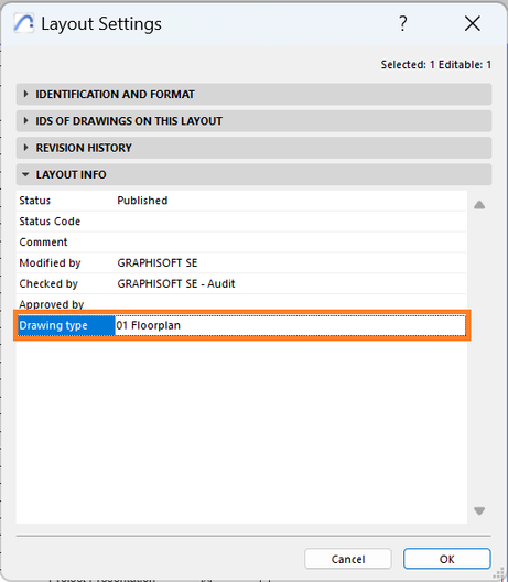

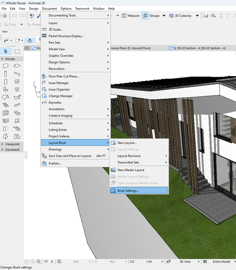

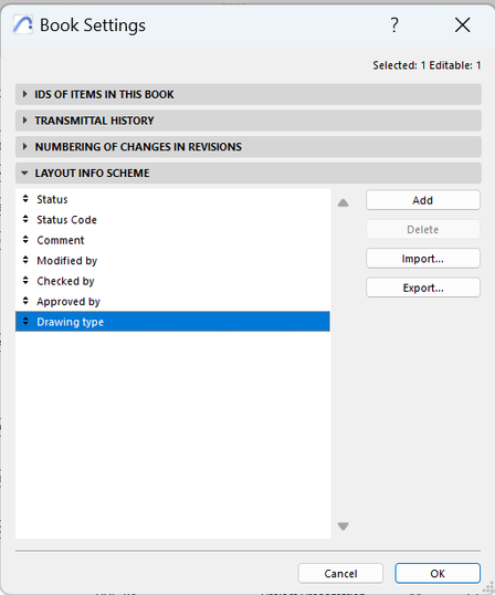

1. Create a new info field in the Layout Info Scheme under Book Settings (e.g., ‘Drawing type’).
2. After creating the ‘Drawing type’ property, assign values to each layout (e.g., ‘Floorplan’ or ‘Elevation’). These values will act as sub-headers, dividing different sheets in the Sheet Index

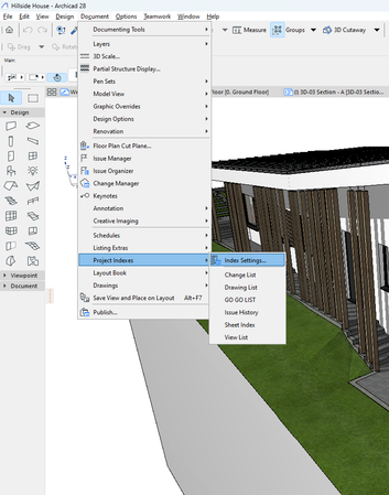

3. Open the Index Settings and include the custom property (in this example it’s ‘Drawing type’) in the Sheet Index fields. This step ensures that ‘Drawing type’ appears as a column in your Sheet Index table.
