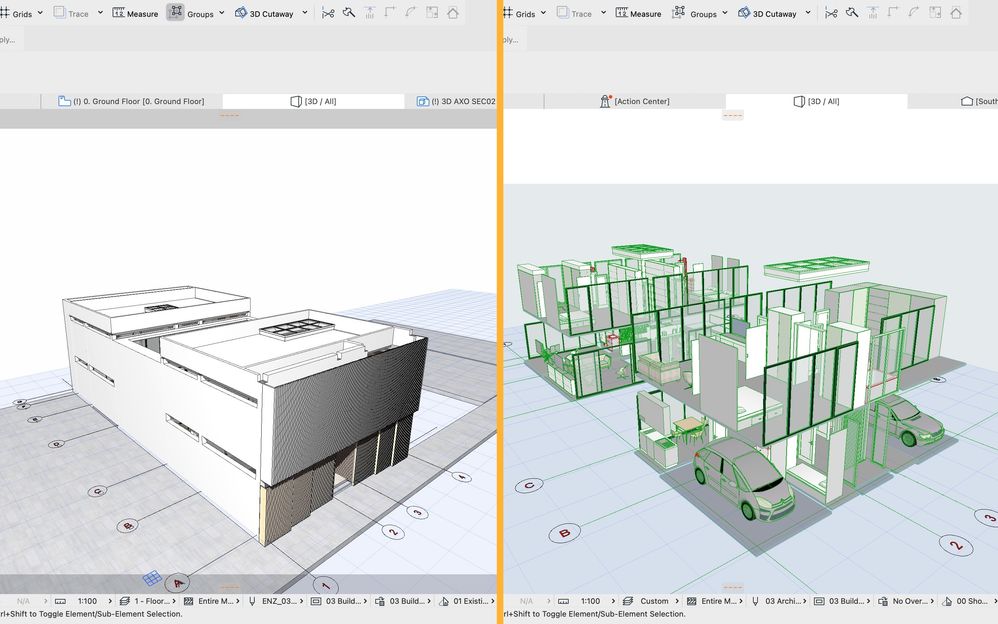

The challenge
Consultants sometimes request an IFC that contains just the openings—doors and windows—so they can focus on checking positions, clearances, and clashes against their structural or MEP models, without the extra geometry of walls, slabs, and other building elements.
Full model (left) vs openings-only IFC export (right)

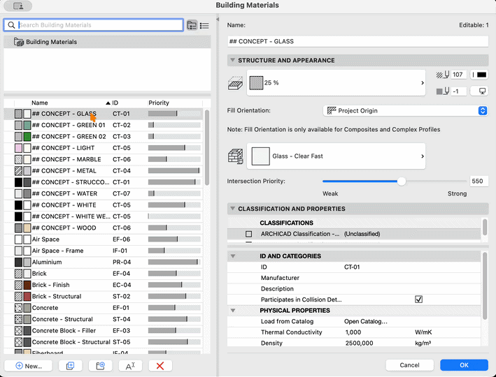

Step 2: Turn off collision detection for all Building Materials
  1. In the export copy, go to Options → Element Attributes → Building Materials….
  2. In the Building Materials dialog, select the first material in the list, then use Shift‑click or a “Select All” command to highlight all Building Materials.
  3. In the properties area, find the “Participates in Collision Detection” checkbox and untick it while all materials are selected.
  4. Confirm with OK to save the change.
From this point on in this copy, no construction element that relies on these materials (walls, slabs, roofs, beams, columns, etc.) is considered to participate in collision detection, which the IFC filter will use in the next step.

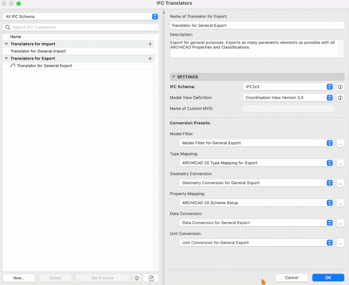

Step 3: Configure the IFC Translator to export only collision‑detection geometries
  1. Open File → Interoperability → IFC → IFC Translators….
  2. Select the translator you normally use for coordination (for example “Exact Geometry Export”), then Duplicate it and rename the copy to something like IFC – Doors & Windows only.
  3. With the new translator selected, click Settings… and go to the Geometry Conversion (or similarly named) panel.
  4. Enable the checkbox “Export only geometries which ‘Participate in Collision Detection’”.
  5. Leave other options (IFC schema version, property sets, etc.) as your office standards require, then click OK to save the translator.
Because all Building Materials now have their collision‑detection flag off, this translator will skip elements built from those materials, but it will still export doors and windows whose geometry is not filtered by that flag.

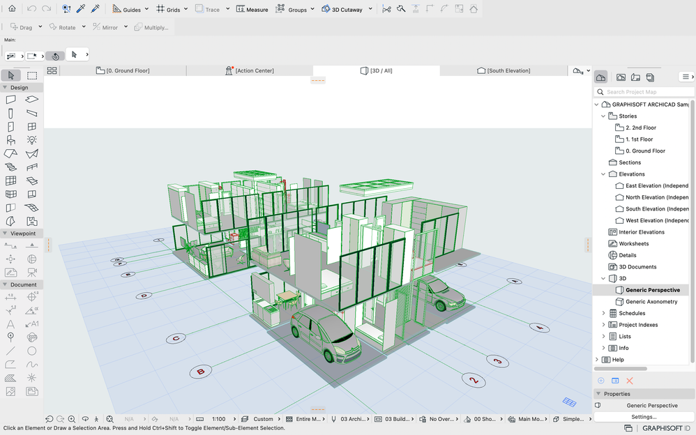

Step 4: Export the IFC with doors and windows only
  1. In the export copy, choose File → Save As… and set the Format / Save as type to IFC File.
  2. Name the file clearly, for example Project_DoorsWindowsOnly.ifc.
  3. In the same dialog, choose the translator you configured (IFC – Doors & Windows only).
  4. Click Save and let Archicad complete the export.
  5. Open the resulting IFC in your preferred viewer or back in Archicad (File → Open… → IFC File) to confirm that it contains doors and windows (and any other pure library parts), but no walls, slabs, beams, or roofs.
Openings-only IFC model
