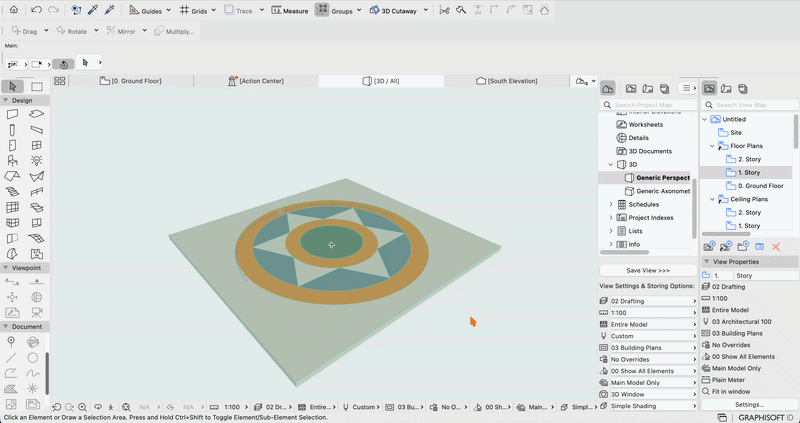

@Adeilson needed to model an inlaid marble floor with a decorative mosaic pattern. The model had to work both for rendering and for extracting accurate quantities in m². Since the detailing would be sent directly to the marble workshop, the result had to be precise!
The floor style that @Adeilson wanted to model. Image: original forum post.The floor style that @Adeilson wanted to model. Image: original forum post.

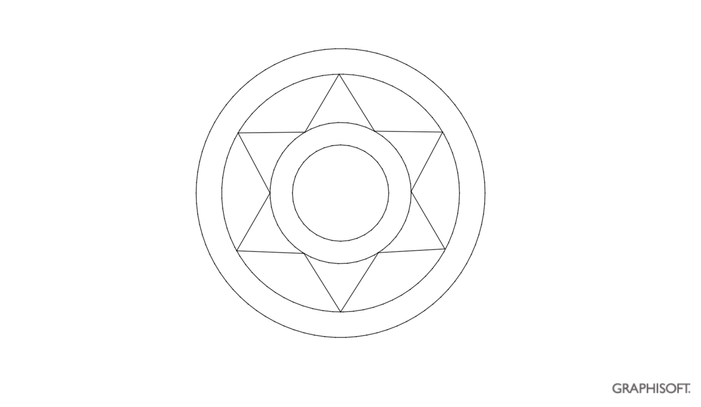

Step 1: Draw the mosaic with lines
On the floor plan, use the Line, Arc/Circle and Polyline tools to draw the desired pattern. Make sure each stone area is a closed shape, so it can be picked up later with the Magic Wand.

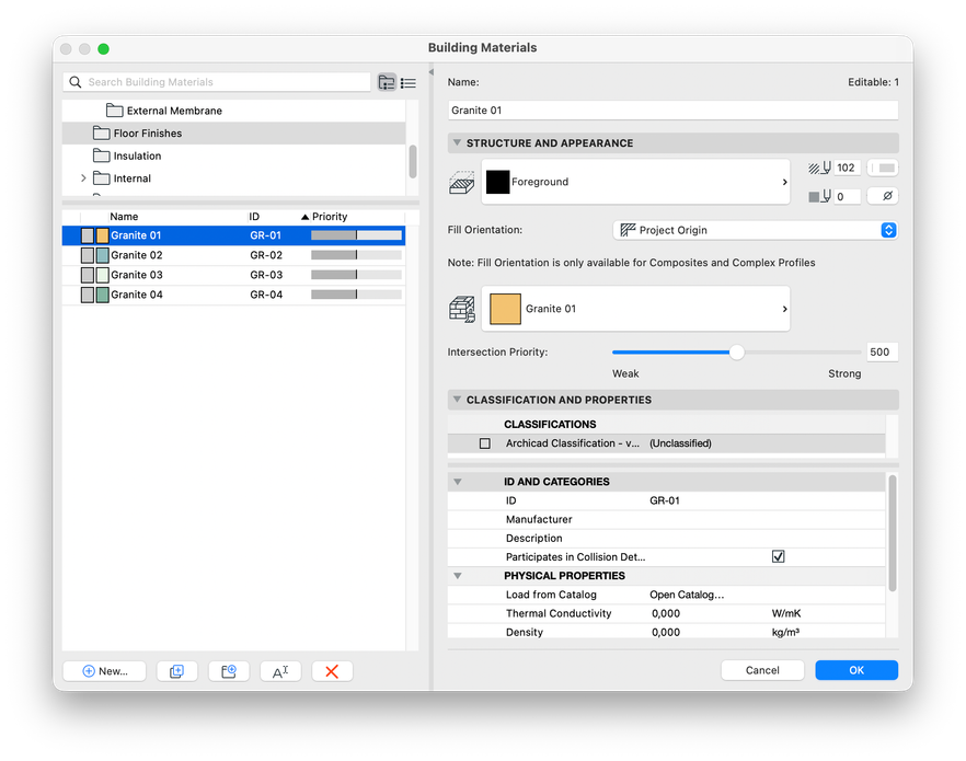

Step 2: Create a material for each stone
Go to Options → Element Attributes → Building Materials and create one attribute per stone type, for example Granite 01, Granite 02, Granite 03 and Granite 04. Giving each one a distinct surface color makes the pattern easy to read in 3D and in schedules.

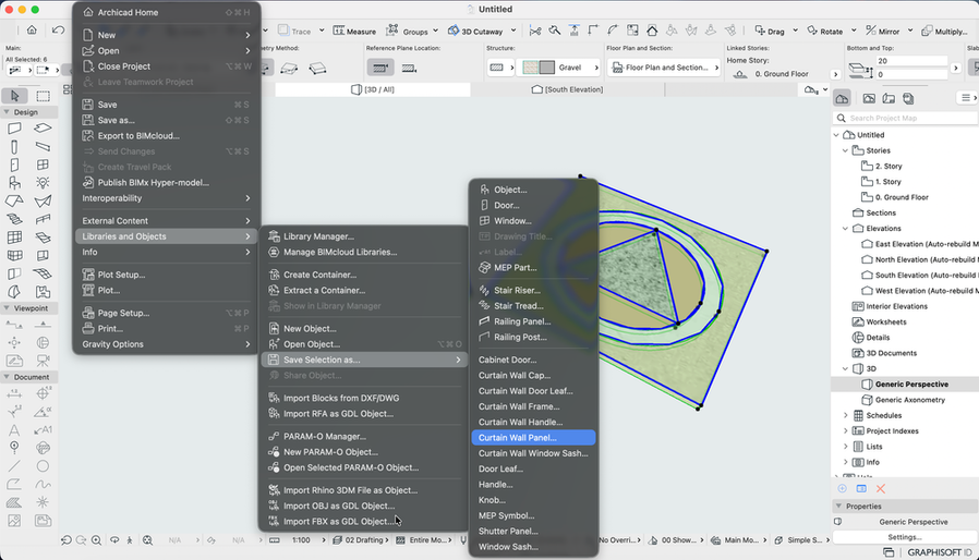

  1. Model the floor tile (or tiles) with the Slab tool.
  2. Select it and save it as a curtain wall panel via File → Libraries and Objects → Save Selection as → Curtain Wall Panel.
Saving the floor model as a curtain wall panel. Image: Rúbia Torres.Saving the floor model as a curtain wall panel. Image: Rúbia Torres.

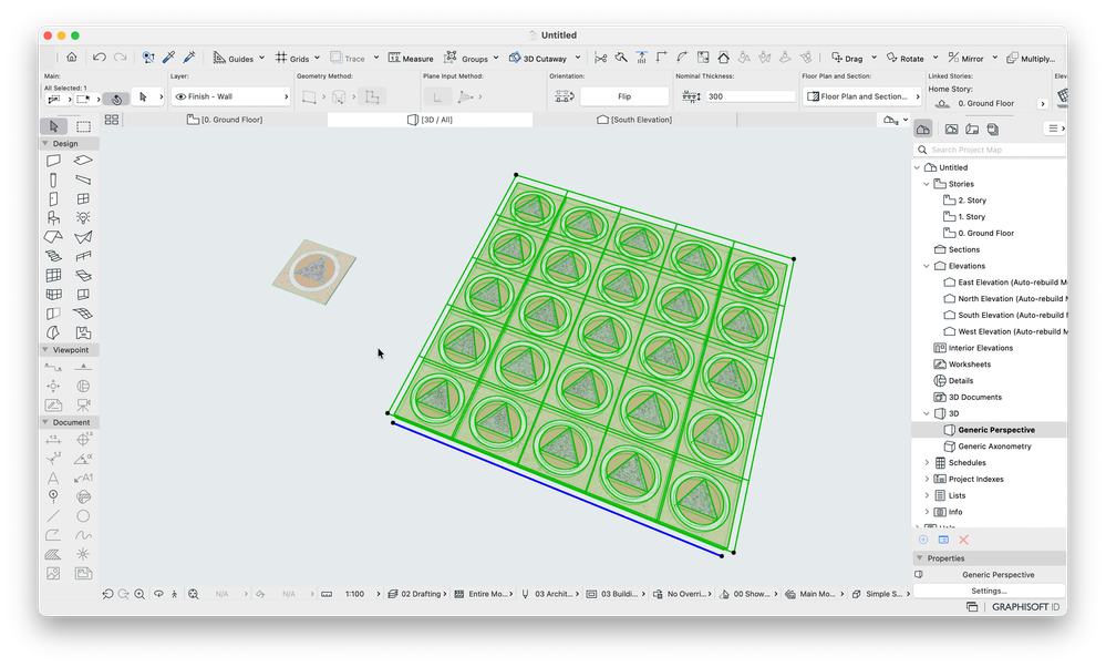

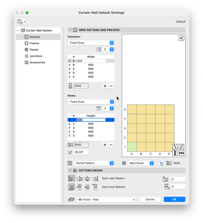

  1. Create a curtain wall using the Frame geometry method and, in the Scheme panel, set the grid to fixed sizes (for example 600 × 600 mm). In the Panels, choose your saved custom creation as the Main Panel.
Curtain Wall scheme with a 600 × 600 mm grid. Image: Rúbia Torres.Curtain Wall scheme with a 600 × 600 mm grid. Image: Rúbia Torres.

Result. Image: Rúbia Torres.Result. Image: Rúbia Torres.
