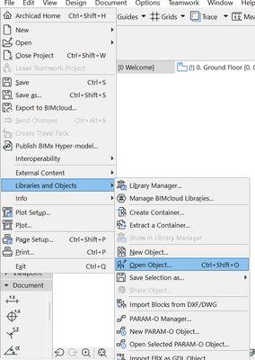

  1. Click on a placed door in your project. Then, go to File > Libraries and Objects > Open Object (or use shortcut Ctrl + Shift + O on Window or Cmd + Shift + O on Mac). MolindaPrey_0-1729727927304.png

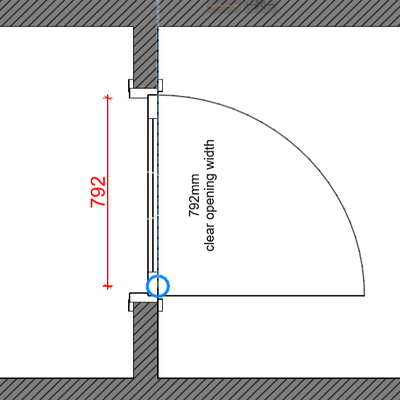

The image below shows both the marker created by @neilmcallister  and the modified door from @Yves
