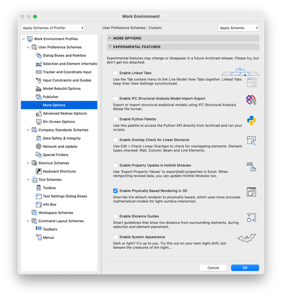

Note that this trick requires Archicad 27 or later and Physically Based Rendering in 3D must be enabled in your Work Environment settings, like this:

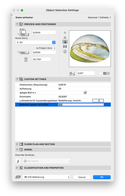

A skydome in Archicad where the external surface is transparent, and the internal surface is a 360o picture of the actual surroundings of the site.
Here’s how
  1. Click here to download the Archicad file which includes the “Dome einfacher” GDL object created by Heimo. Remember to turn on the Physically Based Rendering in 3D (Work Environment settings)
  2. Take a 360o picture with dedicated equipment or download an application for your mobile phone which can create a similar .jpg file
  3. Add your picture to the embedded library in Archicad: File > Libraries and Objects > Library Manager
  4. Edit the GDL object settings to assign your picture (insert the name as it appears in the embedded library):
For more details on the engineering behind this GDL object, check this video.
