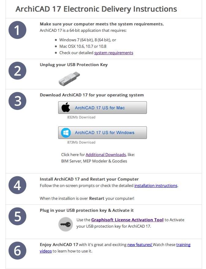

Hope that resolves it. Your email should have linked you to the attached page that has Step 5 concerning upgrading the key.

Bob Moore
Just as you called it. Works fine.
Thanks again.
