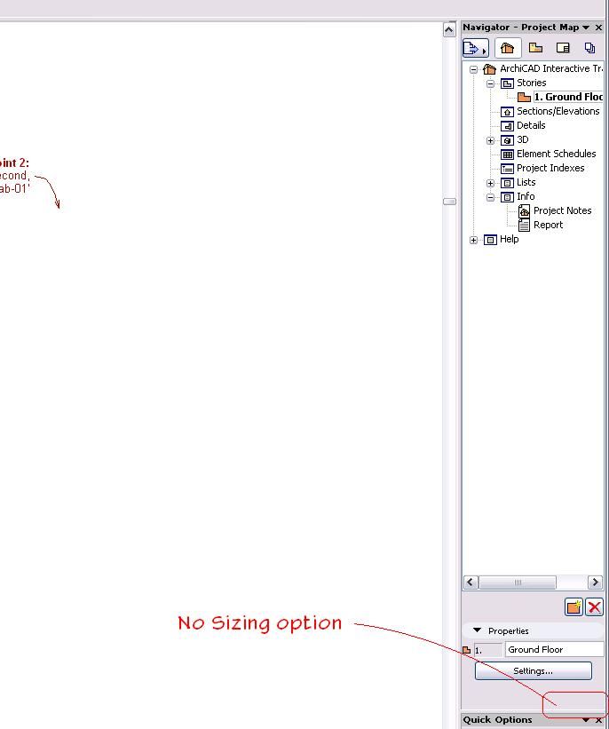

Finally looking into my AC10 Software. Viewing the "Getting Started" video. The Favorite palette is opened and moved beneath the Navigator.
I can not size down the Navigator. See Screen shot.
This is not a good start for me..........

It seems as if the "Standard Profile 10" WE (at least on my PC install) has the palettes docked. The ITG video (on a mac) looks like the they are "floating". I am not sure because I am not as familiar with the Mac-look.

Can you double click on the Title of the Favorites palette in its minimized state? - In the area where you showed there is no buttons?
If you double clicked the Title bar of any docked Palette, it will pop into its previous state somewhere in the screen.
Then you may be able to dock it again in unminimized state.
