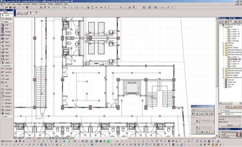

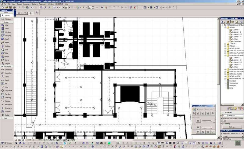

Hi All,
I'm Eddy from Indonesia
My AC11 screen display project is black, Why?
I'm to section & elevation to normally and back to floor plan is black.
A normally floor plan and go up story is screen floor plan is black and go down stroy is screen floor plan is black, Why ?
Please hel me solution..

I'm send picture used Geforce 8800GTX normally condition, why is black?
Please help me solution..

check your fill visibility settings in 'Model View Options'. it looks as though your 'cut' and 'cover' fills are set to 'solid' . . .

I'm check visibility settings in 'Model View Options' a normally not black in fill contours.
my screen AC11 is black together when command ctrl-c (copy) line or fill or object and go up story plan is black and scroll mouse a normally, and when command ctrl-c (copy) and go up story or go down story is black screen and my scroll mouse back to normally, is continous black, normally black normally...

... my screen AC11 is black together when command ctrl-c (copy) line or fill or object and go up story plan is black and scroll mouse a normally, and when command ctrl-c (copy) and go up story or go down story is black screen and my scroll mouse back to normally, is continous black, normally black normally...
ah - then i misunderstood your question. are you saying that your entire screen goes black when you are navigating around? or just that all of your pens are black when normally they are in colour?
if the former, then i would guess that you do have a graphics card problem. if, on the other hand, your problem lies with the pens, you should know that AC11 now saves the penset with the view. if you navigate around your project using the 'View Map' you may be finding that your penset is changing based on your view settings...

I just saw this working on a project. In my case either going up or down a story makes all the elements black until AC does a refresh by itself (mostly a pan), manual rebuild doesn't work. I have been working on this project since last year and this is the first time I have seen this.
It happens with native AC11 files also, just grab an object -> command C (for copy), go up a story and it is black until you pan.

ah! gotcha. i seem to recall this happened way back in an early beta but i thought they had it nailed. for what it's worth, i have no trouble (ATI X1900). does it happen all the time you copy/paste, or is there some specific thing that causes it?

It is very weird. When Command+C and go down one floor it will turn black and it will stay black as long as you don't paste whatever you copied and then do a pan.
My G5's card is a Nvidia GeForce 6800 and this is the first time I see this.
