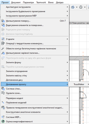

Good day) Faced with such a problem. Why doesn't the add-on install?
6 REPLIES 6
Andrii Levko
Hi Petro, it needs more details, but you can press "Next" (Далi) , What happens then? Have you checked in menubar the "Design/Design Extras" ( в головному меню Проект/ Додатки) , there should be installed accessories and other.

I checked all settings, Desktop. But they are not displayed.

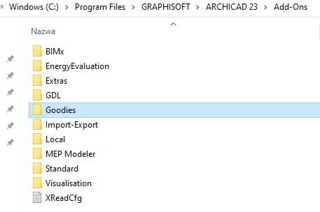

You can only check in menubar or you can also check folder of instalation in Program Files. If it's right folder, there should be installed Accessories library 25 and Goodies folder in Add-ons folder.
Andrii
AC 8.1 - 27 INT/POL 3001
Win11 | Ryzen 5600 | 16 GB | GTX 1650
Yes, these folders are available.
I had such a problem when I had several language versions of Archicad installed, and I accidentally installed the UKR goodies in folder with the International version of Archicad. If you have it downloaded in the appropriate folder, then it is strange, you need to contact your local reseller.

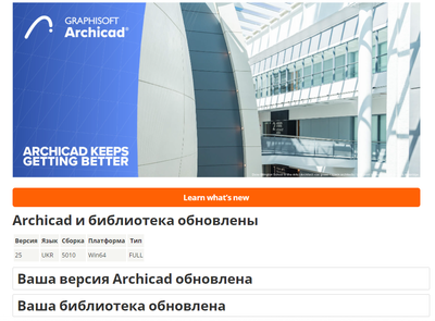

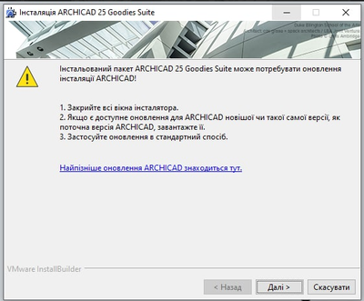

Hi, I don't know if this issue is still valid for you, but recently I came across some information on the Graphisoft website:
The newly installed Goodies are of build 4013. If your Archicad have a higher build you need to run the latest update installer of Archicad. It will update your installed Goodies to the build of your Archicad. This is necessary before you first start working with Goodies. Later when you update your Archicad again, your Goodies will be updated automatically too."
https://Graphisoft.com/downloads/goodies/ac25-ukr
Because Goodies UKR has Build 4013 and Archicad UKR has 5010 Build, maybe this information will be useful for you.
