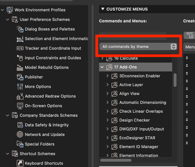

When Archicad first starts up, it copies the work environment from beside Archicad to the user's folder, basically baking in the menu structure. Any add-ons that hasn't been installed beforehand are left out, as it seems.
You can try to solve this by resetting the working environment, or — a more friendly way — put those add-on commands back from the work environment settings dialog (the Menu section).

Finding the add-on commands is not too hard if you switch to "All commands by theme" in the menu section.
My opinion is that having all add-ons putting up main menu items is not too feasible, GS only has something like 50 add-ons in the package.
Let me try to find why AC26 behaves differently; putting them back manually after installation could be the solution for now.
