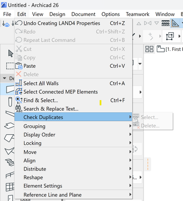

In ArchiCAD 26 USA, the "check duplicates" add-on is available through the edit menu > check duplicates:

2023-04-15 04:21 AM - edited 2023-04-15 04:33 AM
