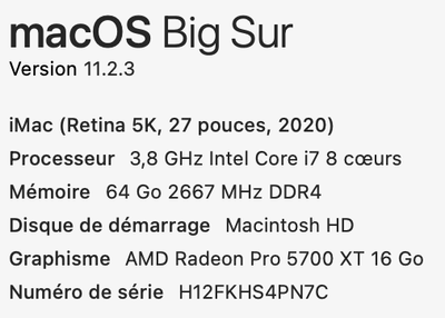

I installed the update hoping it would fix the common "explosions" of Archicad 25 (quitting). Not only did it not help, but now the whole system (Mac OS Big Sur 11.2.3) freezes completely whenever Archicad opens a file. Attaching the system info here:

I don't think it's Big Sur, but AC 4013 update 2. I'm having many issues in AC since update 2 and none in any other software. Surfaces are losing their definitions, elevations are randomly changing settings--several others. Very frustrating. I'm running the latest OS version 11.6.1. These issues are worse than the more minor glitches reported in Monterey. New M1 Max on the way.

@amgam Why are you running the very old Big Sur 11.2.3 and not the most recent 11.6.1 update?

Isn't my post the answer? I only updated Archicad as the original installation of 25 didn't run smooth and had many problems, especially AC turning off few times a day, (crash).
I don't update often because these updates usually do more bad than good.

Update two is not sufficient by itself; you will also need to be running macOS 11.3 or greater. Try it...
