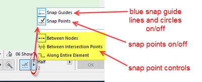

The blue guide lines and guide circles and spot (small blue circle around a node) (all activated quickly with 'Q' shortcut) are different to the snap points that mark locations along an edge/line.
The blue guide lines and guide circles and spot are all controlled together so if you are getting the lines but not the spots, I don't know what would cause that.
Does adjusting the cursor range in the Work Environment affect the guide spots around the nodes?
It might make it easier to find the nodes if the range is larger.
