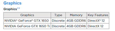

This machine seems to have an option of 2 graphics cards.
It seems to me you system is capable.

I have the 'Lenovo Legion 5 15ARH05' computer.
Hereby some information about my computer:
CPU
AMD Ryzen 7
Memory
16 GB RAM
Disk
SSD (with 370 GB of free space)
Graphics card
Display resolution
FHD+
Operating system
Windows 11
Protection key
Everything meets the minimum requirements.
Only I don't know where to find the info about the graphics card and the protection key.
Arwen
