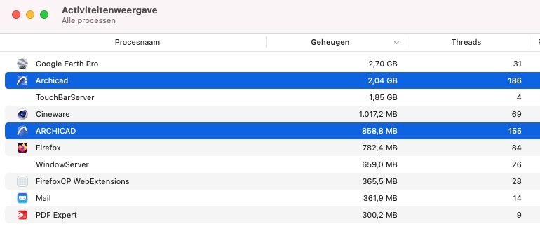

MIXD
Hi Francois,
I notice this issue also on my OSX system. Archicad V26 seems to use 2,5 time as much RAM memory versus V 24 when actually no recent tasks are pending.
The pln files are almost similar. The screenshot is from a stable period over a longer timespan...
I encountered freezing issues during updating views also, this behaviour disappeared after deleting a 3D library object (man walking). Is this memory use a side effect of cropping the views?   See: https://help.graphisoft.com/AC/23/int/_AC23_Help/005_NewFeatures/005_NewFeatures-26.htm
Andries MIXD
MacBook pro 16 inch. 2,4 GHz 8-Core Intel Core i9, 64 Gb, Archicad 26-27
