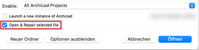

We have experienced that the option ‚Fade Environment‘ in the Design Options palette can be responsible for error messages related to Direct3D. If deactivated, the issue no longer occurs.
In this case, the problem may be resolved by repairing the PLN file.
Understanding the "Open and Repair" Function in Archicad: Tracking Repaired and Removed Elements – S...
... und noch viel mehr bei a-null.com
