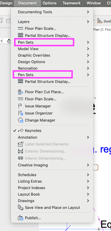

In AC29 the menu has two pen settings that are duplicates of each other.  I cannot see how to remove the unnecessary extra item.  See attached screencaptures.  Scott

You also have two Partial Structure Displays.
Check the menu structure in your Work Environment.
I would be guessing you are using a custom WE possibly from an older version instead of a default 29 WE.
It should be easy to edit out the duplicates and re-save your custom WE.

Thank you Barry.  I have been modifying the as supplied template WE but did not add those menu items.  Scott
