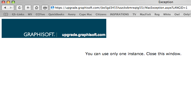

Can't upgrade USB key to A/C 10
I'm on an Intel iMac 20", 2 GB Ram, 256 Mg Video card, 500 GB hard drive, OS 10.4.6 with updated Java.
Finally got A/C 10 by transferring from another Mac 17" laptop. What a pain. This proceedure should be documented somewhere and obvious for the thousands that now own Intel Macs.
Now I am unable to update my full version USB key to be able to use the new program. I go to the site:
https://upgrade.graphisoft.com
and get the message: "You can only use one instance. Close Window"
I've never been to this site before so cannot have used it before. Apparently, the site thinks I am trying to upgrade another key. I own only one. My reseller did ask for my key number several weeks ago when I ordered the update, and I used a program he sent me to extract the number for him.
I am using the latest version of Safari and tried Firefox with same result.

Did you try rebooting? I think this message is referring to an instance as a connection to the upgrade database.
Reboot and try again and see if that leads to success.

There will be a native Macintel AC10 soon. But until then, I'd try putting the key on the "other mac 17" and upgrade it there.
I experienced the same problem updating my WIBU key on Windows XP. I opened the WIBU-KEY dialog box in the control panel/ Install Tab/ and selected the Plug & Play button (I think this essentially uninstalls all instances of the WIBU application so that when you restart and insert the USB key it reinstalls it). I restarted my computer/ inserted the USB key and installed the device from the ArchiCAD 10 CD. Then I navigated to the update graphisoft page and it worked as it should have the first time.
Thanks everyone. I spoke at great length to a Graphisoft rep. and tried many different tacks to fix things. He said that the problem is a problem with the Mac Java and ArchiCAD, and even the newest version (which I have) does not resolve the problem. He also suggested that I try using the Powerbook G4 17" to try updating the key as you also suggested. That worked and all is well. Thanks for all the help ! Chris

Hey Aaron, I could bring my old G4 on Friday if nothing else works for you. It's weird though that the PC upgraded key doesn't work. It should be cross platform - mine is. Are you using the Mactel compatible WIBU driver?
I installed the WIBU driver from the graphisoft website yesterday. But, I just went to www.wibu.com and installed the latest from there and now it worrks just fine.

I have talked to GS about this and they say it is a driver problem with the USB ports on the intel Macs.
If you try to upgrade your key in windows on an iMac, it just crashes your browser and produces a log file on your desktop.
They say they are working on it now, so it should be ready soon.
