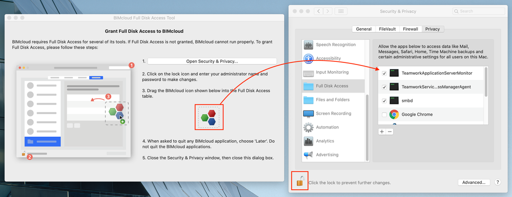

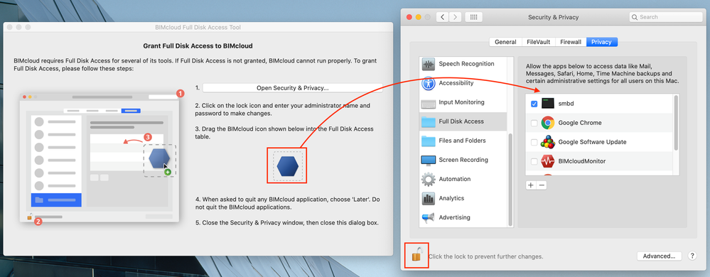

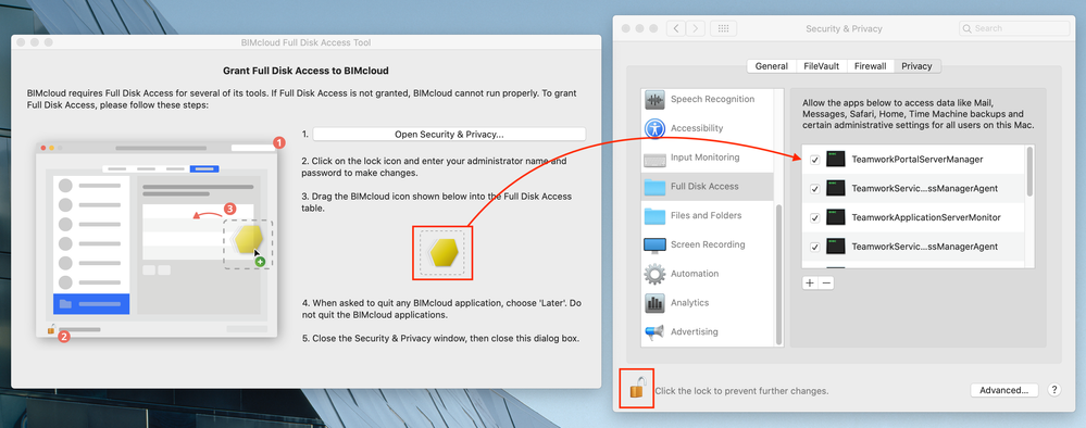

    Full Disk Access Tool (from BIMcloud 2019.4 to BIMcloud 2023.3):
    When the installation step of the installation / update process of the BIMcloud Manager / BIMcloud Server / Delta Cache is done, the Full Disk Access Tool automatically starts.
    Depending on the currently installed / updated BIMcloud component, the Full Disk Access Tool will offer you the icon of the BIMcloud component to drag & drop to the Full Disk Access list.
    1. When the Full Disk Access Tool shows up, click on the "Open Security & Privacy" button.
    2. On the Security & Privacy window click on the lock icon on the bottom.
    3. Type in an administrator username and password and press OK.
    4. Drag & Drop the installed / updated BIMcloud component's icon from the Full Disk Access Tool to the Full Disk Access list.

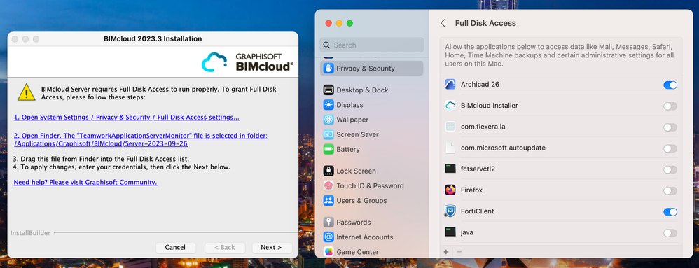

    Installer (From BIMcloud 2023.3)
    In the next window of the installer, you can set full disk access:
    1. Click on the "Open System Settings / Privacy & Security / Full Disk Access settings" link - It will open the Full Disk Access settings
    2. In the Installer dialog click on the "Open Finder..." link - It will show the BIMcloud component selected in the Finder window.
    3. Drag the selected file from the Finder window into the Full Disk Access List.
    4. On the Installer dialog click on the "Next" button
    These permissions must be set for each and every BIMcloud component individually. When more than one BIMcloud Basic is installed on the same computer, you must repeat for each installation the process of adding all BIMcloud Basic’s components to the Full Disk Access list to get the right permissions for each BIMcloud Basic’s correct operation.

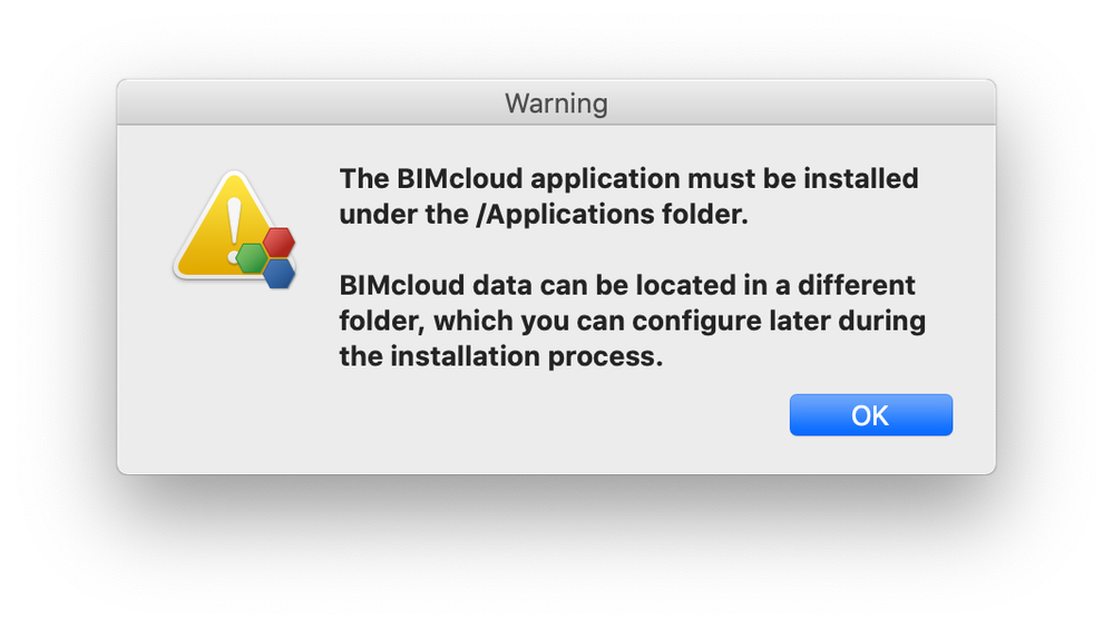

In case of a clean installation, the BIMcloud installer will help to get through the right processes. Before data can be installed, it will detect whether the installation location is in the Applications folder or not. For any other location other than the default path or a folder inside of Applications, a warning message will appear:
