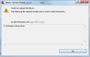

Custom folder icon issue
Starting with ARCHICAD 17 build 6004 a restriction was made in accepted filenames and paths with BIM Server Libraries. BIM Server Libraries that contain filenames or paths that are invalid on Windows or Macintosh can no longer be uploaded. The reason was that users who worked cross-platform might have discovered several issues with invalid filenames and paths.
Issue:
User created a custom folder icon for a Library folder on Macintosh and could not upload this library to a BIM Server.
Cause:
While creating a custom folder icon on Macintosh, a file named Icon? will be created automatically. This Icon? filename is not acceptable on Windows, so user can not upload this library to a BIM Server.
Solution:
Avoid creating Custom Folder Icons in libraries on Macintosh. Also avoid using any other non cross-platform filenames.

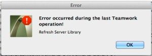

Error messages:
In AC17 the error message did not contain much information:
In AC18 the error message will look like this:
