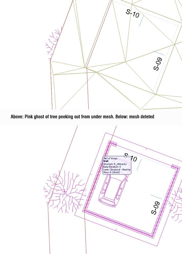

I have ghost story on to show above current story - but when I go to my 'site' ( -1) story the house above won't ghost unless I pan. As soon as I let go of the mouse button the ghost dissapears. On my site story I have only a mesh and a few 2D lines. The weird thing is that I have a tree object on my 0 story that peeks out partially from under the mesh in ghost. As soon as I delete my mesh in -1 the ghost works fine. I tried display order but no luck.

Your mesh has a Cover Fill applied to it. You need to use either the Mesh Settings or Model View Options to turn it off/hide it.
