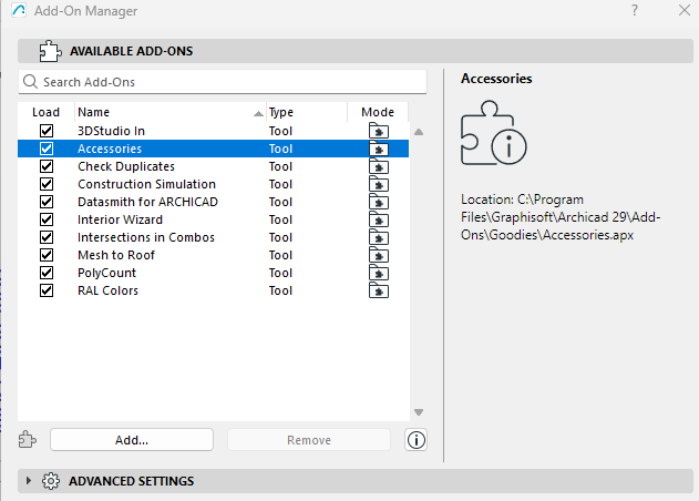

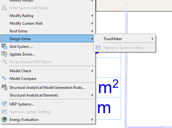

I wanted to make a ceiling in my project. For that I use this tutorial: https://www.youtube.com/watch?v=aJNulKwpnX0
I make a zone, I select it but there's problem - when I open Design -> Design extras, I don't have "interior wizard" tab. I have only Truss Maker.
I was thinking, that I don't have the add on installed, but I checked it and I have every add on in my folder. Is there other way to do that? Why it doesn't work if I have add ons installed in my archicad folder?

Are you using a custom Work Environment from an older version of Archicad?
If so you will need to add the commands to that WE (menus and/or tool bars).
Or you could try choosing one of the default 29 Work Environments.
This post talks about the possible cause of this situation:
https://community.graphisoft.com/t5/Modeling/Accessories-not-found-after-installation-in-AC26/m-p/35...
You will also need to load the Accessories Library.
