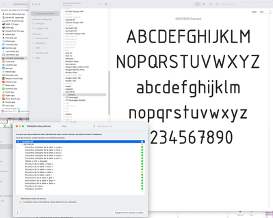

.ttf file should work, did you try to open and verify them with the Font Book app ?
