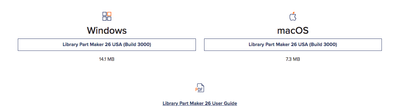

Hi Barry,
For archicad 27 Yes but no apple silicon version for Archicad 26

Sorry I missed the  version 26 part.
No, there seems to be no link for USA 25 ARM.
But I copied the link for INT 26 ARM and changed it to USA.
That seems to have worked as it downloaded for me - not that I can test it.
