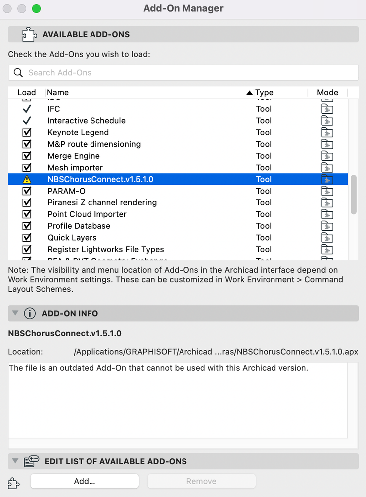

Has anyone had any success in installing the NBS Chorus plug in?
I tried following the installation steps but it says that the plug in is out of date. Is this out of my control or am I missing something?
Thanks in advance.
Operating system used: Mac Intel-based

Are you trying to install in 28?
It looks like the add-ons on the Graphisoft website are on 26 and 27 (although it does not say 27 on the web page, it is 27 when you download it).
I am trying to install in 28 but I tried yesterday with 27 and had the same issue then.
The download is definitely only for 27, so it won't work in 28.
Should be fine in 27 unless maybe you downloaded the silicon version? - I don't know about Macs.

Hi Fraser, did you get yours to work? it's is still saying outdated and I'm running v27 6000UKI on Apple Silicon.
RSL
Not an issue, closed all Archicad - replaced the add-on - reopened - all working.
