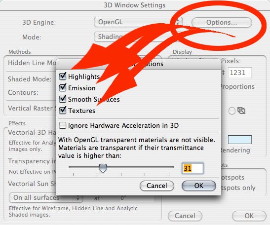

I find when using openGL in 3D generation, more system memory is used. For instances, I have a model when using openGL , 1.2G memory is used. When using ArchiCAD internal engine, 600MB is used.
Meanwhile I have a bigger model. It is OK when using ArchiCAD internal engine but program error and quit while using OpenGL.

To conserve memory when using Open GL, reduce options, especially textures, that take a lot of memory to calculate.
