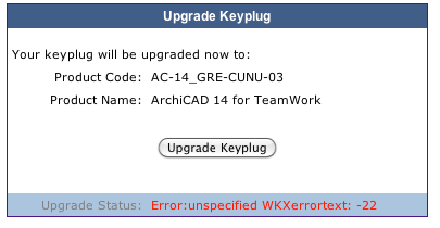

Achille Pavlidis
Hi, i too face problems updating the wibu key to AC 14.
The key is on the server, and when i tried to update (with Safari) i got this message: see attached image.
