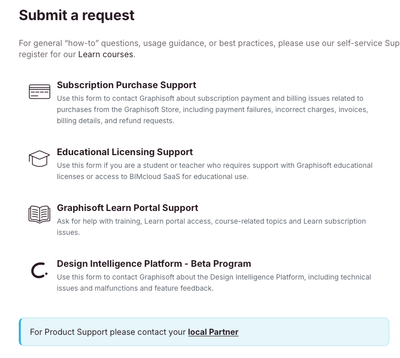

Achille Pavlidis
Hi Karl,
I haven't submitted to techical support, as I didn't find any suitable category...
 I was hoping someone from GS would see this and open a ticket
Mac OS 26.1 | AC 29.1.0 INT 4006 FULL
If you don't see 'Product Support' on that page, then use the 'Local Support' link at the bottom.
Here in Australia/New Zealand, we only just got 'Product Support' last week.
I will ask at the next moderators meeting in a couple of days, if everyone is supposed to see 'Product Support'.
I have forwarded this bug to GS Community Tech Support.
