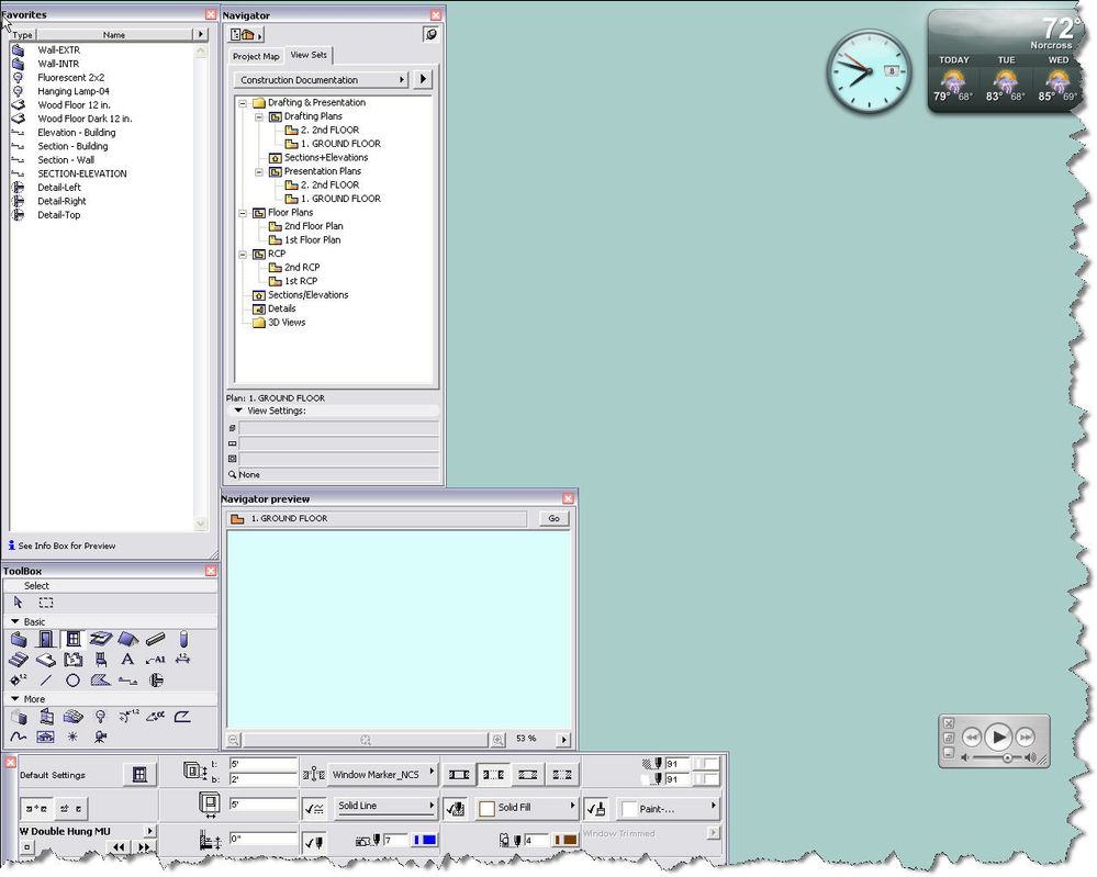

I bought 2 monitors with the same dream.. Looks like AC makes you work in 2d OR 3d, but never at the same time. I use the second monitor for all palletes though..

This doesn't happen if you do not maximize the 2D and 3D windows. Stretch the AC window over both monitors, then size the other windows as desired.
Still, I tend to run AC maximized on the primary (usually with 2D maximized as well) and put palettes on the 2nd monitor - notably view editor and nav preview.

I have the 2D window to the max extents on my left monitor together with the info box which I can toggle on or off with F4 key, the 3D window maxed out on the right monitor together with the nav preview and navigator which I can also toggle on/off with F5. Works great!
It freaks my clients out when they see me go with the mouse from one screen to the other and back again.
