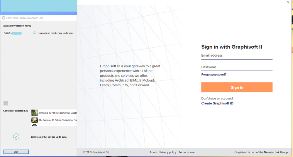

I have AC 16 and this version is enaugh for my job. So, when I try enter to AC I received 503 Error. AC is not detected License Key and showed me register site. GS Dealer is hard to talk and is not to give me email and password to enter the AC? How can I start AC with a registration key without login credentials for sites I never had?

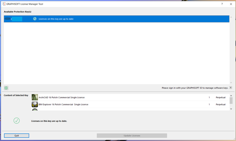

If you open the License Manager tool on the other machine, does that recognise the license?
Can you also show the License Manager screen? - but be sure to blank out the license number - just to be safe.
This is weird for me as well. But yes, when I open the License Manager tool on the other machine, does not that recognise the license, and information I have the same as on your picture.
After my job I'll send to You the License Manager screen without the license number.

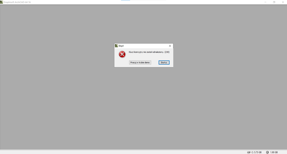

PRTSc_3 is in Polish and that's mean: "The license key was not found (230)" or another error nr (503) with the same sentences. I couldn't find the errors code numbers?

This is pretty strange.  If license manager can read the info on the USB key, then the issue isn't a problem with the USB port itself (with "try another port" or "reboot" being the solution).
So... since it is Archicad that doesn't see the keyplug, I wonder if perhaps you don't just need to update or reinstall your Codemeter or WIBUkey software?  Being Archicad 16, I suppose you might have a WIBU key (plastic)?  If it is shiny metal, it is Codemeter.  See what version of runtime you have vs what is available here:
https://www.wibu.com/us/support/user/downloads-user-software.html

It looks like your license is fine.
The 'Sign in with Graphisoft ID' is not needed - that is only if you have software licenses to manage.
If Archicad won't run when you start it then as Karl suggests, I would check you have the correct WIBU (green plastic USB) or Codemeter (silver metal USB) drivers installed.
Maybe it is just a case of installing the latest update for 16 - or even re-installing 16 again.
This should install the correct drivers.

Then that will be a WIBU key.
You can find the drivers here ... https://graphisoft.com/downloads/protection_key
