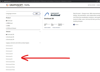

Thanks for your reply Nurbs...my problem is I don't have anything between 15 and 28.  any ideas?
You can download and install AC 26. Your license should be able to open this ( if you have a cloud license you have to install the latest update as well). With this version you can open the AC 15 file and save as AC 26. Then open it in AC 28.
