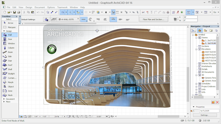

- ARCHICAD 16 running on Windows 8

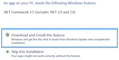

- ARCHICAD 15 and older versions require .NET Framework 2.0, which is no longer part of the the default Windows installation. During the installation Windows offers the installation of the latest .NET Framework, make sure you choose Download and install this feature there.
Not doing so may lead to not working features in ARCHICAD like the Movie Player or the ARCHICAD YouTube channel.
