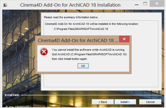

i have problem when i trying to install Cinema 4D Add-On for ArchiCAD 18
when i try to install it it keeps coming up "you cannot install this software while archicad is running.."
I do not have the program open... and i restarted my pc to make sure its not open, and the same problem comes up

Apparently this Add-On thinks that ArchiCAD is still running, maybe some setting got corrupted.
If this doesn't resolve, try to first reinstall (repair) ArchiCAD, and then retry installing the C4D Add-On.

Hi, go to your installation folder. Right click on archicad.exe and click properties. Uncheck "Read only". That should help

I also had this problem. That helped. Thanks!
