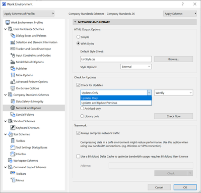

This option can be also turned on/off through the work environment in case you change your mind. Please check the screenshot below.
