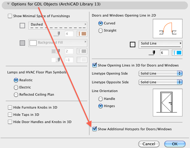

This is potentially great (screenshot attached) - no need to modify every window and door to get the hotspots to show.
But, it is a documentation disaster waiting to happen!! Suppose you dimension to the extra hotspots - for example to get outside of casing to outside of casing for adjacent windows. If another view turns off those hotspots, the dimensions jump to some other hotspot - giving bogus dimension chains and numbers. Turning the hotspots on again with the an MVO that has the extra hotspots on will not restore any of the dimensions. They are toast.
Associative dimensions are to hotspots, so this is 'correct' behavior - but is an example of why GS should NOT have put this feature into the MVO.
My advice: if you use the extra hotspots for any kind of dimensioning, modify every single MVO to make sure that the extra hotspots are enabled, and when you create a new MVO, similarly enable them.
